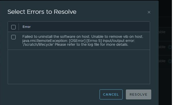

  • Uninstallation of NSX-T from an ESXi host fails via the Manager UI.
  • Error message indicates a java.rmi.RemoteException involving an input/output error at the /scratch/lifecycle path.
    Failed to uninstall the software on host. Unable to remove vib on host.
    java.rmi.RemoteException: [OSError] [Errno 5] Input/output error:
    '/scratch/lifecycle' Please refer to the log file for more details.
