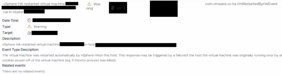

  • The following event is observed in vCenter Server at the Cluster level:
  • "The virtual machine was restarted automatically by vSphere HA on this host. This response may be triggered by a failure of the host on which the virtual machine was originally running, or by an unclean power-off of the virtual machine (e.g., if the VMX process was killed)"

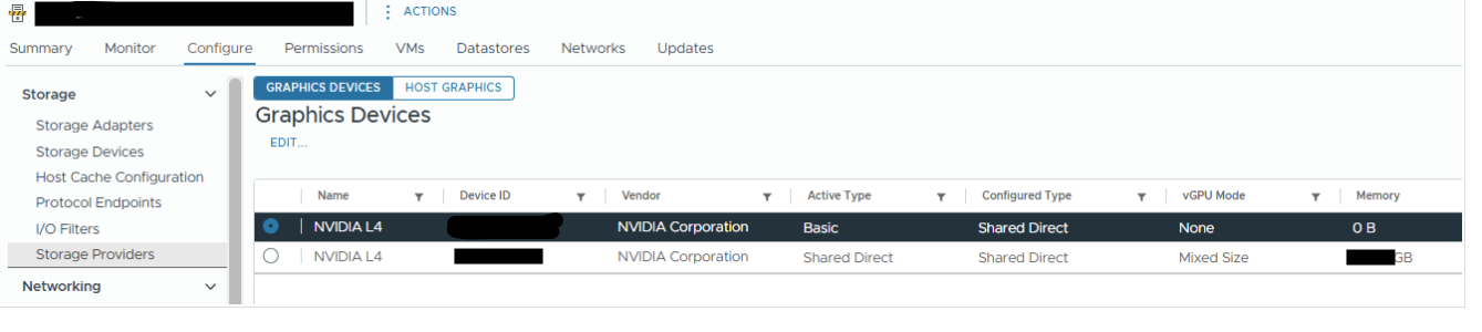

  • Additionally, memory utilization for the NVIDIA L4 GPU shows 0 (The utilization reports correctly again after the ESXi host reboot).
