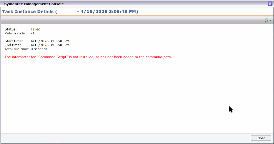

Users may encounter failures when running Command Script or PowerShell tasks on specific client machines. The tasks fail immediately with an error stating that the necessary interpreter (such as cmd.exe or powershell.exe) is not installed or cannot be found, even though these interpreters are present and functional on the local system.
The interpreter for "Command Script" is not installed, or has not been added to the command path.
The interpreter for "PowerShell Windows" is not installed, or has not been added to the command path.
