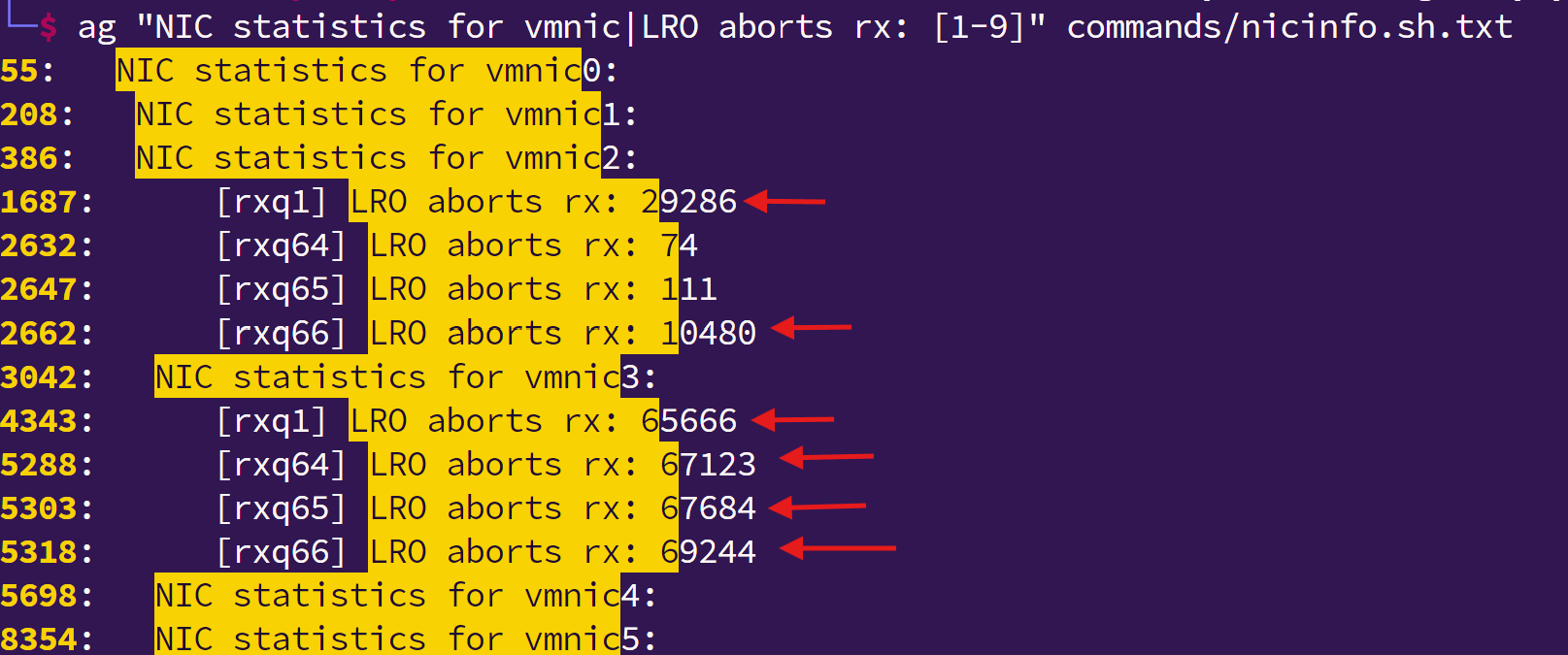

Verification of the Issue:
  • Review the ESXi support bundle to confirm if LRO aborts are occurring on the vmnics used for the NSX datapath.
              Run the following command from the root directory of the log bundle:
              ag "NIC statistics for vmnic|LRO aborts rx: [1-9]" commands/nicinfo.sh.txt
If "LRO aborts rx" values are high (as shown above) on vmnics used for NSX traffic, proceed to the workaround.
