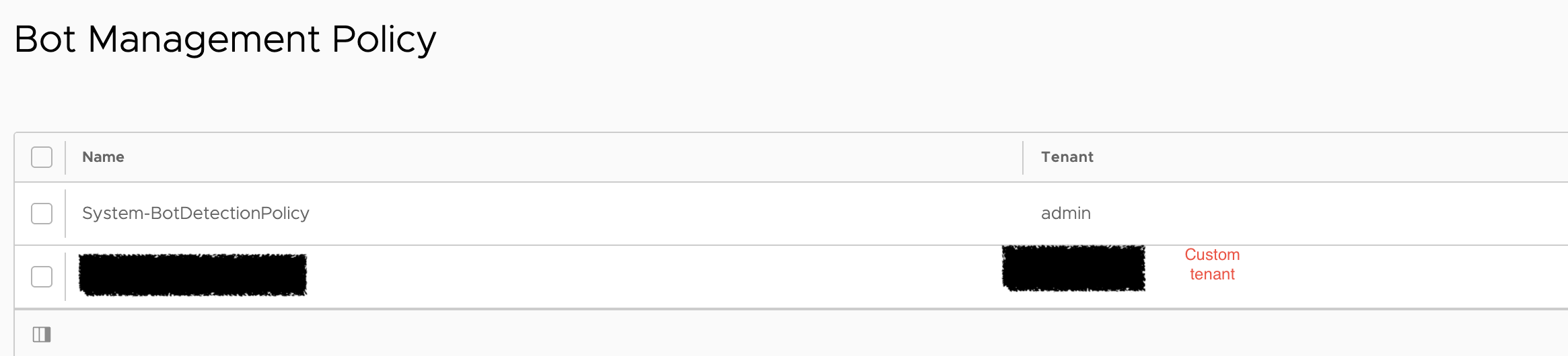

If there are more than One Bot Detection policies present in AVI Load Balancer controller this issue will occur.
Verification:
  1.  Login to AVI Load balancer controller UI.
  2. Select "All Tenants" Option on the Top-Right Side
  3. Navigate to Templates >> Bot >> Bot Management.  Verify if there are more than One Bot Detection policy is present

Please remove the custom BotDetectionPolicy from the AVI Controller UI and use only System Defined Bot detection Policy in Ingress configuration.
This is a BUG from AVI side and It will be fixed in future releases.
