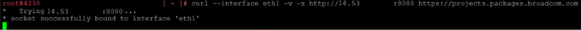

  • If the Supervisor is using the proxy to access the projects.packages.broadcom.com then Verify the network connectivity to the projects.packages.broadcom.com via proxy IP form the eth1 (Workload network.) which is failing.
  • Validate the management interface eth0 able to communicate to projects.packages.broadcom.com via proxy IP.

The Local Consumption Interface (LCI) service installation will fail if connectivity to the external proxy over eth1 (used for workload traffic) is unsuccessful.
The physical firewall to allow traffic from the NSX VPC (private subnet connected to eth1) external blocks CIDR to the external proxy IP.
