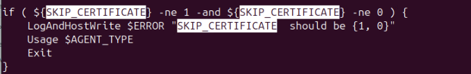

The telegraf-utils.ps1 script was looking for input validation check for the SKIP_CERTIFICATE variable. If the script is executed without the -k argument, the variable remains in an invalid state, triggering the validation failure.
Below is the "SKIP_CERTIFICATE" reference within the telegraf-utils.ps1 script
To complete the Telegraf agent installation, execute the installation script using the -k parameter with a value of 1 as given below:
.\telegraf-utils.ps1 product-managed -t <token>  -v <vmwareariaoperations_ip_or_fqdn>  -c <cloud_proxy_ip_or_collector_group_name> -k 1
