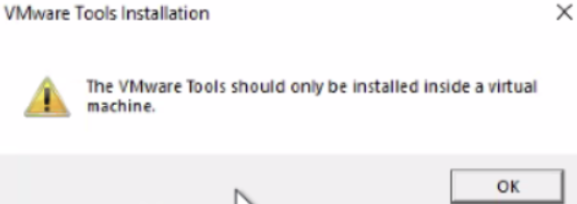

  • Issue reported on Windows virtual machines running on vSphere environment about the VMware Tools as stated below.
    The VMware tools should only be installed on virtual machine
  • Error information:
  • During the VMware tools installation procedure, if the option "Virtual Machine Validation" is skipped, VMware tools can be installed, but the service can not be started.
    • Go to Run --> services.msc and click on the VMware tools service, it reports "The VMware Tools service entered the running state" and "The VMware Tools service entered the stopped state " with Event ID 7036.

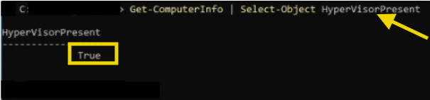

    • Login to the VM console and use PowerShell command for the validation from Windows command line:
      • Get-ComputerInfo | Select-Object HyperVisorPresent
    • If the output is "True", the VMware Tools installation will fail with error noted above, and the service may not start.
