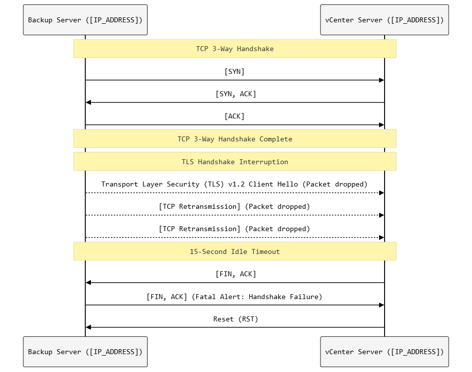

  • The following diagram illustrates the sequence observed during the handshake failure:

  • Review of the packet capture (pcap) shows the completion of the TCP three-way handshake. However, the Transport Layer Security (TLS) v1.2 Client Hello sent by the backup server does not arrive at the vCenter Server. After multiple TCP retransmissions and a 15-second idle timeout, the connection terminates with a fatal handshake failure alert and a Reset (RST) packet.

d. Review the complete handshake . (Refer the image on Issue / Introduction)
