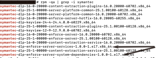

After upgrading there are rhel7 packages from a previous install (16.0 RU2 and below) are still installed.

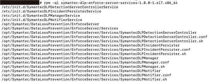

when removing the packages marked el7 the config files for the services will be removed.
if you run "rpm -ql package" you can see all the files that package will install or remove.
Removing the el7 without affecting the 25.1 install and configuration run the following:
rpm -e --nodeps --justdb --noscripts $(rpm -qa | grep -i symantec | grep -i el7)
