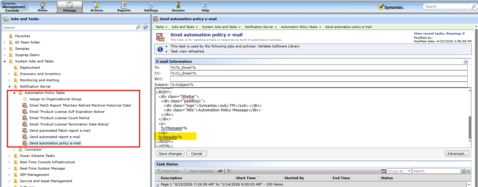

1. Verify Task Configuration and Tokens
The most frequent cause of blank emails is the absence of the results token in the task assigned to the Automation Policy.
  • On the SMP Console, navigate to Manage > Jobs and Tasks >  System Jobs and Tasks > Notification Server > Automation Policy Tasks.
  • Locate the specific Send Email task used by your Automation Policy.
    Note: cloning the Send automation policy e-mail task is the most common approach
  • In the Message section, ensure that %!Results!% is present in the body.
    • Note: If using custom HTML, ensure the token is not hidden inside a malformed tag.

      Just to check if there is an issue with the default HTML provided in the  "Send automation policy e-mail" task, you can try:
      1. Modify "Send automation policy e-mail" task or similar ones to add the results without HTML formatting.
        1. For example - clone the "Send automation policy e-mail" task.
        2. Replace the message content
      with just:
      %!Message!%
      %!Results!%
      1. Then select this new task in the automation policy and set up the parameters as you did before. And you'll receive correct results with the proper spacing that you can copy and paste in excel for example.
    • Expected Result:
      • Report data is injected into the email body.
      If Missing:
      • Add the token and save the task.

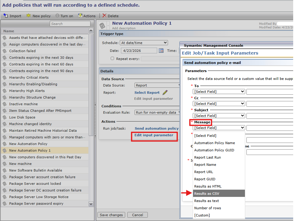

  • Navigate to Manage > Automation Policies.
  • Select your Automation policy
  • In the Actions section, click Edit Input Parameter and change the "Results" dropdown to Results as CSV for example.
    Save changes and click Test Automation Policy.
  • Validation: If the CSV arrives with data but the inline version does not, the issue is likely related to HTML rendering or report size limits.
