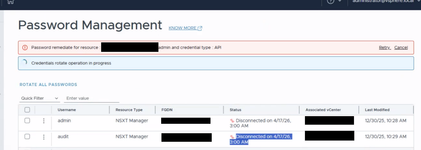

You may encounter an issue where attempting to rotate NSX Manager passwords from the SDDC Manager interface is unsuccessful. In this scenario, you will typically observe the following symptoms:
  • NSX Managers appear as disconnected from the SDDC Manager.
  • You are unable to change the passwords for the admin and audit accounts through the standard interface.
  • You still have access to the root password and can successfully log in to the NSX-T Manager using VCF SSO.

7. Remediate the associated user on SDDC
    > Navigate back to Password Management in SDDC Manager.
    > Locate the admin and audit accounts that are showing as "Disconnected".
    > Click the three dots next to each and select Remediate.
    > Enter the new passwords you just established via the OS shell.
After completing these steps, attempt to log in to the NSX Manager UI again. The login should now be successful.
