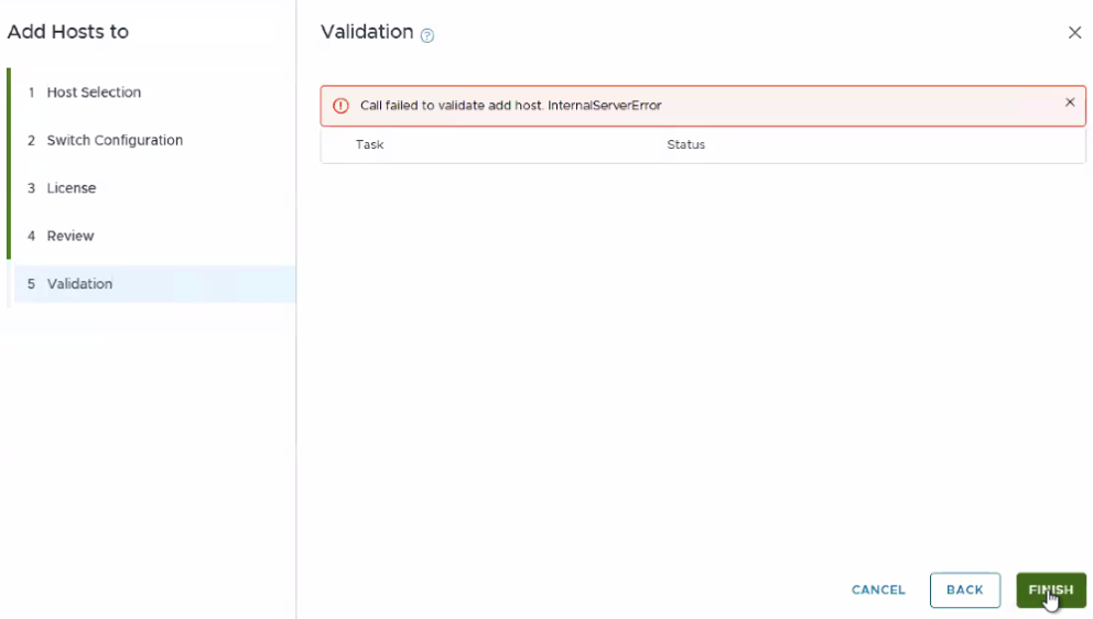

  • When attempting to add an ESXi host to a cluster via the SDDC Manager UI, the workflow fails at the Validation step.
  • The SDDC Manager UI displays the following error banner: Call failed to validate add host. InternalServerError
  • If validating via API /v1/clusters/{id}/validations to perform validation of the ClusterUpdateSpec, the response as well returns the below
    "errorCode": "PUBLIC_INTERNAL_SERVER_ERROR",
    "arguments": [],
    "message": "InternalServerError",
    "causes": [
            "type": "java.lang.NullPointerException",
            "message": "Cannot invoke \"java.util.List.stream()\" because the return value of \"com.vmware.evo.sddc.inventory.model.HostAttributes.getPhysicalNics()\" is null"

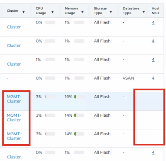

  • When viewing the hosts in the SDDC Manager UI (under Inventory > Hosts), the Host NICs column is completely blank for the affected cluster, whereas hosts on the other cluster display the number of NICs:
