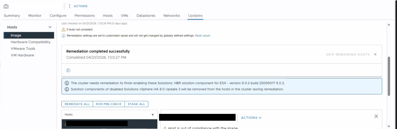

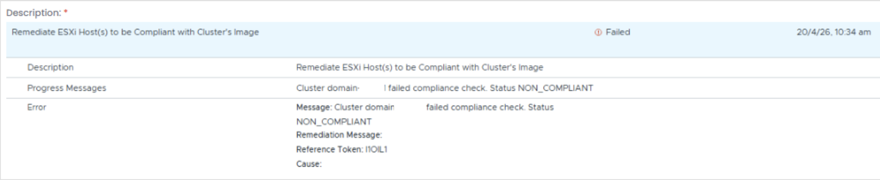

When creating or expanding a cluster in VMware Cloud Foundation (VCF) SDDC Manager, the task fails during remediation. The SDDC Manager UI reports the cluster is NON_COMPLIANT
In the vCenter, we see that the remediation is complete
In /log/vmware/vcf/sddc-support/sos/sddc/var/log/vmware/vcf/domainmanagerdomainmanager.log, the following error is observed:
YYYY-MM-DD ERROR [vcf_dm,#######,#######] [c.v.v.clustermanager.ClusterSpecUtil,dm-exec-9] Cannot skip 3 ESXi host(s) ([<HOST1>, <HOST_2>, <HOST_3>]), as only 0 ESXi host(s) would remain which is not sufficient. Minimum requirement is 2
YYYY-MM-DD ERROR [vcf_dm,#######,#######] [c.v.e.s.o.model.error.ErrorFactory,dm-exec-9]  SKIP_FAILED_HOSTS_NOT_ENOUGH_HEALTHY_HOSTS_WOULD_REMAIN
