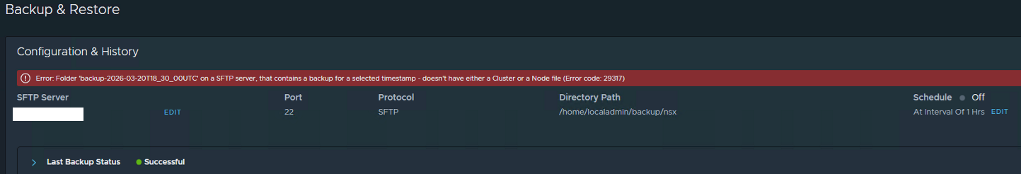

Error: Folder '####' on a SFTP server, that contains a backup for a selected timestamp - doesn't have either a Cluster or a Node file (Error code: 29317)/var/log/proton/nsxapi.log indicate a mismatch between the expected FQDN and the FQDN found in the backup metadata.http-nio-127.0.0.1-7440-exec-8 ClusterRestoreFacadeImpl 81264 SYSTEM [nsx@6876 comp="nsx-manager" level="INFO" subcomp="manager"] Expected cluster backup file : {nsx-ufo-backup-restore=/cluster-node-backups/4.2.3.2.0.25077149-IPv4-####-###-####-###-####-nsxmg01.###.####.co.in/backup-2026-03-20T18_30_00UTC/cluster_backup-####-####-###-###-#####-nsxmg01.###.####.co.in-nsx-ufo-backup-restore.tar}http-nio-127.0.0.1-7440-exec-8 ClusterRestoreFacadeImpl 81264 SYSTEM [nsx@6876 comp="nsx-manager" level="INFO" subcomp="manager"] Expected node backup file : /cluster-node-backups/4.2.3.2.0.25077149-IPv4-####-####-###-###-####-####nsxmg01.###.#####.co.in/backup-2026-03-20T18_30_00UTC/node_backup-####-###-###-###-####-####nsxmg01.###.###.co.in.tarhttp-nio-127.0.0.1-7440-exec-8 ClusterRestoreFacadeImpl 81264 SYSTEM [nsx@6876 comp="nsx-manager" level="INFO" subcomp="manager"] Existing backup file : /home/localadmin/backup/nsx/cluster-node-backups/4.2.3.2.0.25077149-IPv4-####-###-###-####-####-###nsxmg01.###.####.co.in/backup-2026-03-20T18_30_00UTC/cluster_backup-#####-###-###-###-####-####nsxmg02.####.####.co.in-nsx-ufo-backup-restore.tarhttp-nio-127.0.0.1-7440-exec-8 ClusterRestoreFacadeImpl 81264 SYSTEM [nsx@6876 comp="nsx-manager" level="INFO" subcomp="manager"] Existing backup file : /home/localadmin/backup/nsx/cluster-node-backups/4.2.3.2.0.25077149-IPv4-####-###-####-####-####-####nsxmg01.###.####.co.in/backup-2026-03-20T18_30_00UTC/node_backup-####-####-###-###-#####-####nsxmg02.####.#####.co.in.tarVMware NSX
