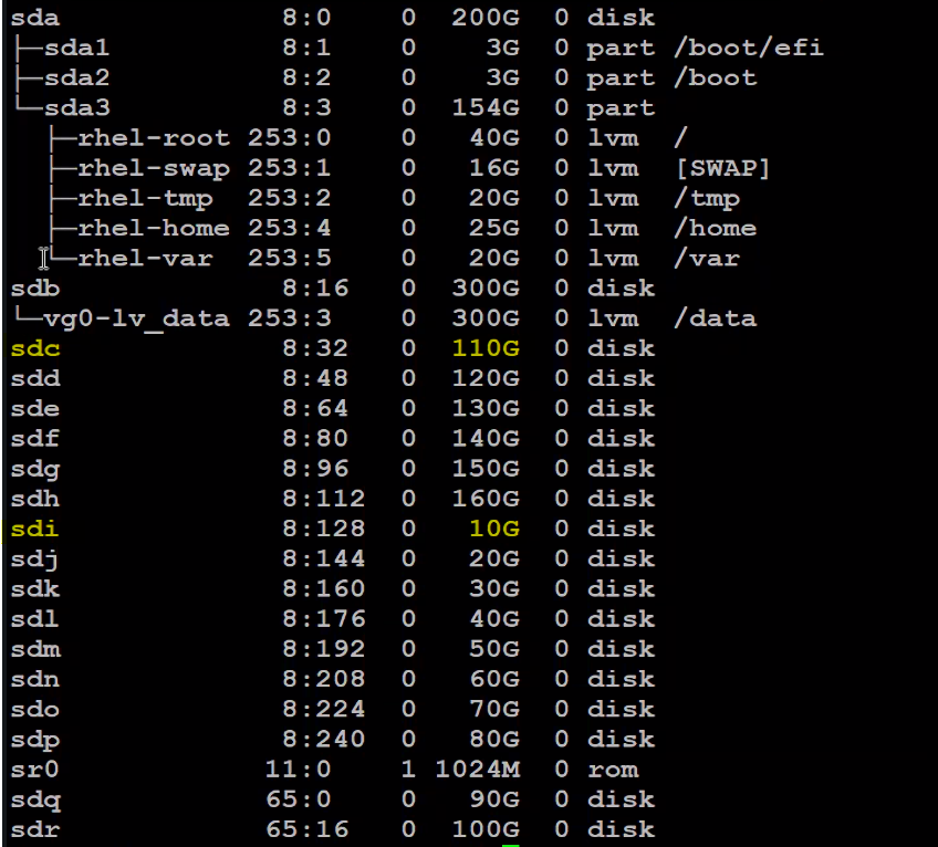

  • When the multi-writer flag is enabled on an Oracle Linux VM, the guest operating system experiences non-deterministic device naming upon reboot.
  • The below screenshot explicitly highlights two specific disk mappings with command to validate: lsbl
    1. sdc is currently mapped to a 110G disk.
    2. sdi is currently mapped to a 10G disk.
  • Because the Multi-writer flag causes the OS to probe these disks in parallel during boot, the kernel assigns the /dev/sd* paths non-deterministically

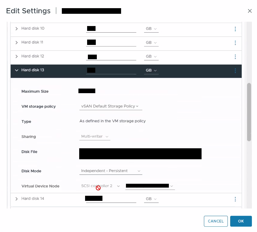

  • Configuration of the Linux VM with the multi-writer flag is as below:

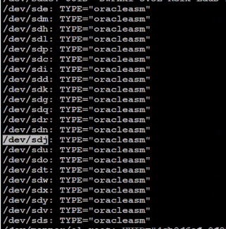

  • Disk details inside the GuestOS are as below where these disks are configured for Oracle Automatic Storage Management (ASM). In a clustered Oracle environment (like Oracle RAC), multiple virtual machines must have concurrent read/write access to the same shared disks. The hypervisor's Multi-writer flag allows this sharing:
