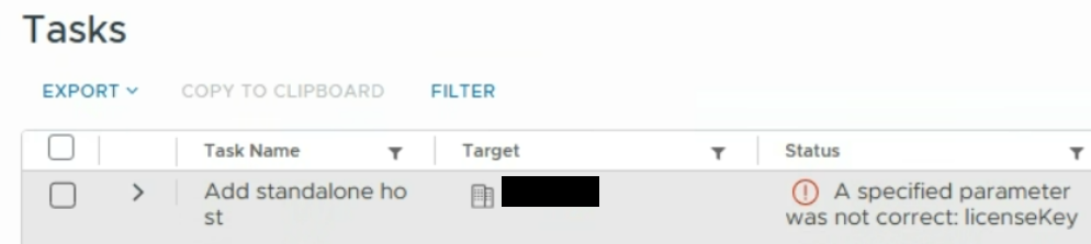

  • Adding a Standalone ESXi host or reconnecting a disconnected host to vCenter fails.
  • The following error is observed in the vCenter UI > Monitor > Tasks:
    A specified parameter was not correct: licenseKey
