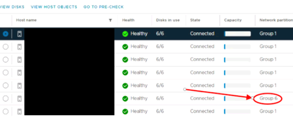

Host is showing as in its own cluster in the vCenter UI, which indicates it did not join the existing cluster.

The ports needed for vSAN to work correctly were closed after being opened by vSAN when enabled.
  • TDP/UDP 23451 - Reliable Datagram Transport (RDT)
  • TCP/UDP 12345 - Clustering Service (CMMDS)
  • UDP 13221 - Stretched Cluster / Witness
Verify the following ports are open.
Troubleshooting network and TCP/UDP port connectivity issues on Hosts
Use “netcat” (nc) with the following syntax for checking TCP ports on a remote host.
#nc -z <destination IP> <destination Port>
For UDP ports, use this syntax.
#nc -zu <destination IP> <destination Port>
You are looking for a response of, “succeeded” after running the commands.
