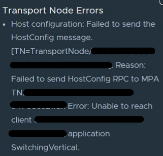

  • NSX install fails with error "Failed to send the HostConfig message.xxxxxxxxx.."
  • Resolve action or an attempt to reprepare the host fails.
  • On the ESXi host, stale NSX properties are present from a previous install remain, even when there are no NSX VIBs.
