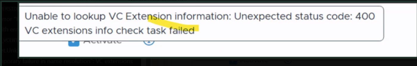

In VCF Operations Administration > Integrations > vCenter > When attempting to save the integration it fails with error " Unable to lookup VC Extension information: Unexpected status code: 400 VC extensions info check task failed"
