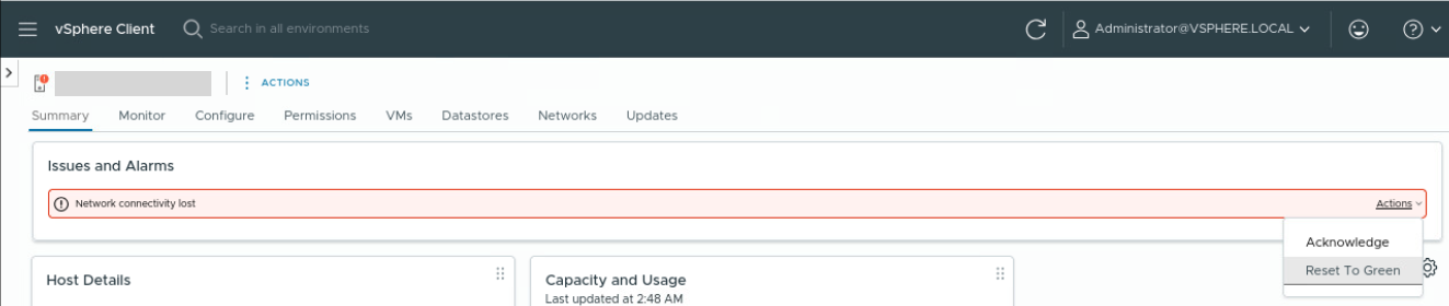

  • The "Network connectivity lost" alarm is observed triggering for the target ESXi host in the vSphere Client.
  • The VMkernel Adapter migration is complete, and there are no communication issues with the network of the target ESXi host.

The alarm can be cleared by navigating to [Actions] > [Reset To Green]. If the alarm does not trigger again and there are no communication issues, no further action is required.
