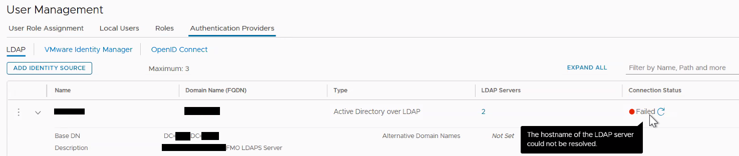

  • The Connection Status of LDAP server at User Management > Authentication Providers > LDAP  shows "Failed".
  • When you scroll over the mouse on it, you'd see an error message - "The hostname of the LDAP server could not be resolved"
