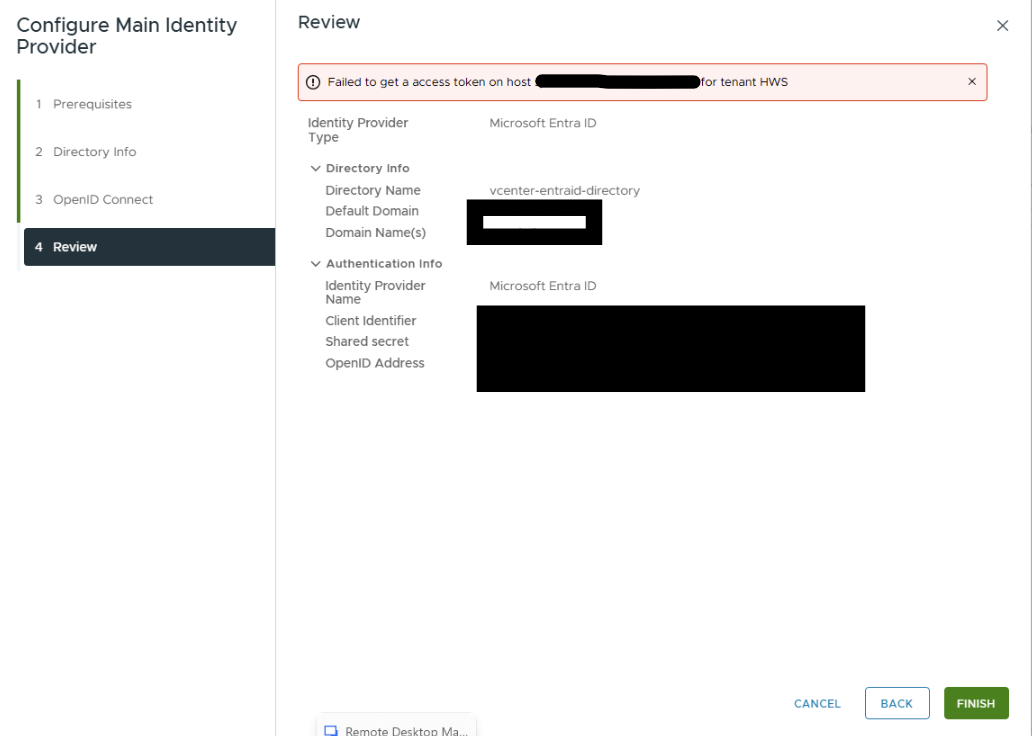

vCenter Microsoft Entra ID provider change fails with error "Failed to get an access token on host <VC_FQDN> for tenant HWS"
Article ID: 437622
VMware vCenter Server
In the vCenter UI page, change of provider to Microsoft Entra ID fails with the below error :
1. /var/log/vmware/trustmanagement/trustmanagement-svcs.log
YYYY-MM-DDT06:57:13.974Z [main [] ERROR com.vmware.sync.subscribe.SusbscribeDbStore  opId=] SusbscribeDbStore intialized with dbUserName: trustmanagement_sync_db
YYYY-MM-DDT06:57:56.707Z [ws1bTLSCertExpiryCheckerScheduler-1 [] ERROR com.vmware.vcenter.trustmanagement.authbroker.TenantInitializer  opId=] Failed to create WS1 namespace 'ws1'
YYYY-MM-DDT07:02:59.943Z [tomcat-exec-19 [] ERROR com.vmware.vcenter.trustmanagement.authbroker.BrokerClient  opId=] Failed to get a access token on host <vc_fqdn> for tenant HWS
YYYY-MM-DDT07:02:59.943Z [tomcat-exec-19 [] ERROR com.vmware.vcenter.trustmanagement.migration.IdpReplacer  opId=] Replace operation failed. Attempting rollback. Triggering exception is: Failed to get a access token on host <vc_fqdn> for tenant HWS
YYYY-MM-DDT07:02:59.943Z [tomcat-exec-19 [] ERROR com.vmware.vcenter.trustmanagement.migration.IdentityMigration  opId=] Error changing identity provider configuration: Failed to get a access token on host <vc_fqdn> for tenant HWS
