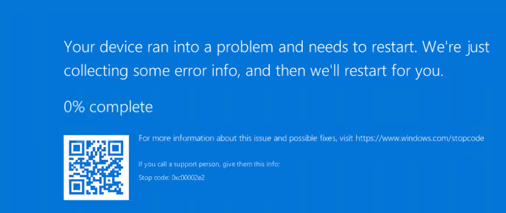

Symptoms
Below error is reflected on the Domain Controller VM on Boot:Stop code 0xc00002e2 indicates a Windows Domain Controller failure caused by Active Directory database corruption or an old backup
