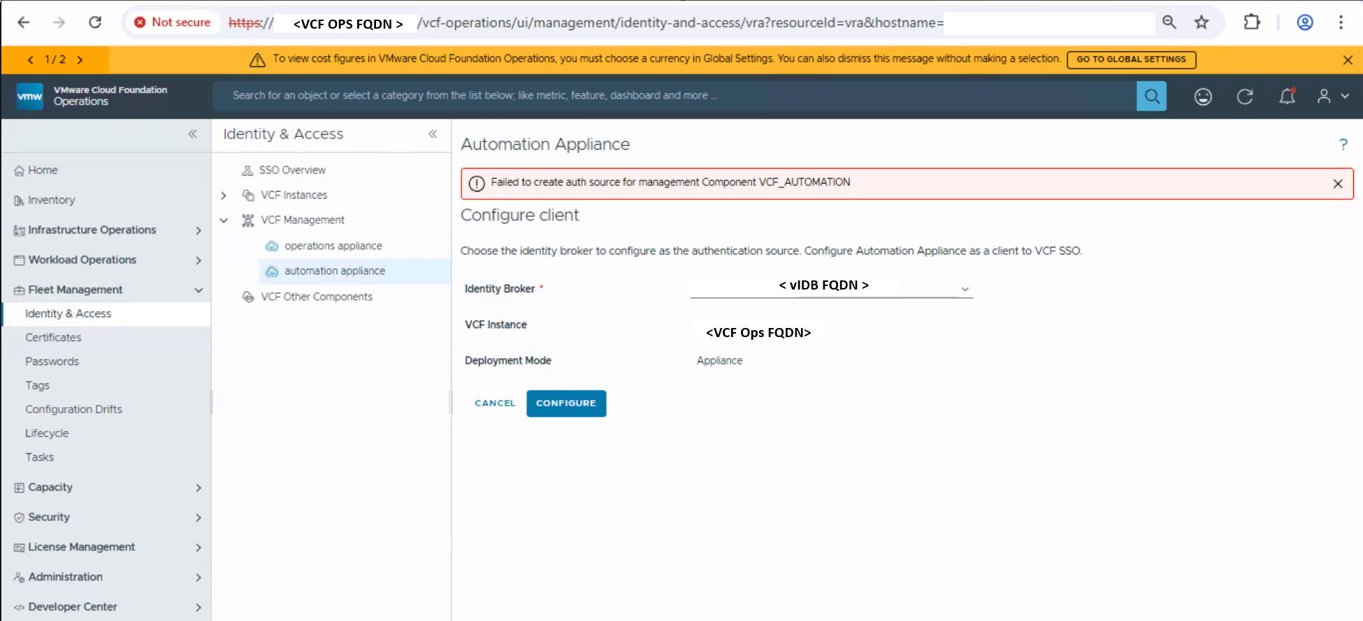

  • From VCF Operations > Fleet Management > Identity & Access > VCF Management > Automation Appliance, attempting to configure SSO for the VCF Automation Appliance fails, and the process returns the following error: "Failed to create auth source for management component VCF_AUTOMATION."
