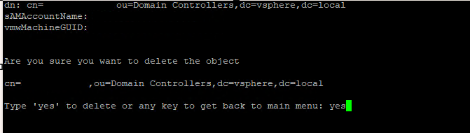

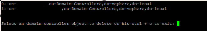

4) When the script runs you will be presented with a list of domain controllers
5) Follow the on-screen prompts to view the domain controllers, input the old PNID number(0 in our case), and confirm the deletion.
6) Once the script finishes, it shows the below screen, which means the duplicate entry of domain controller is removed.
7) Restart vCenter services or resume the PNID change workflow.
