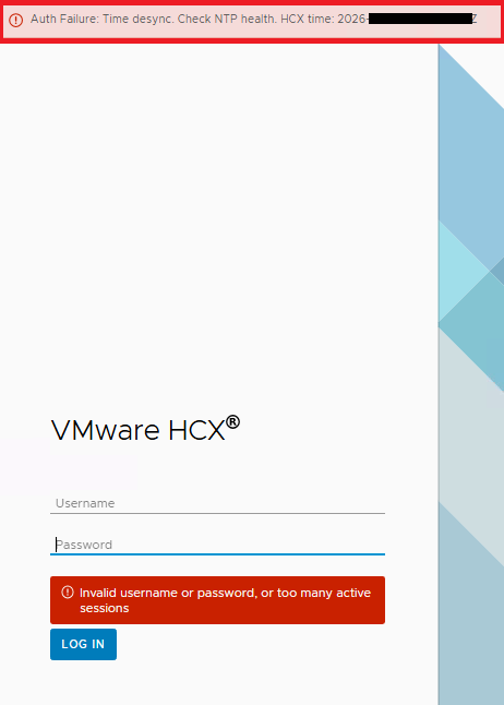

If you attempt to log in to HCX, you may encounter the following errors depending on how you are accessing the HCX Manager.
  • HCX 443 UI hybridity page:
Error: Auth Failure: Time desync. Check NTP health. HCX time: 20##-##-##T##:##:##.###Z

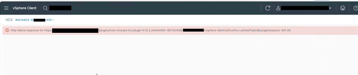

  • vCenter UI HCX plugin shows below error :
Error: Http failure response for https://vcsa.com/plugins/com.vmware.hcx.plugin-4.##.##.######## -- 8#######8/10.##.##.##-443/vsphere-client/ui/hcx/hcx-ui/rest/hybridity/api/sessions: 401 OK
