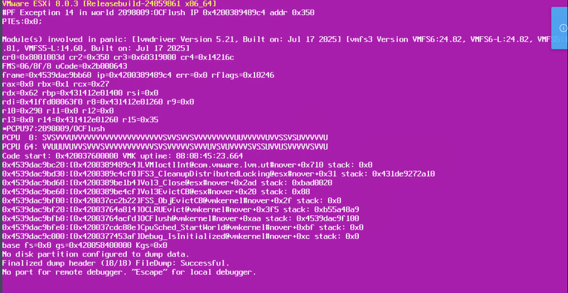

ESXi host experiences a Purple Screen of Death (PSOD) with an error message similar to: @BlueScreen: #PF Exception 14 in world 2098009:OCFlush IP 0x4200389489c4 addr 0x350
The back trace may include references to VMFS, LVM, or OCFlush modules.
PSOD Screenshot for reference:
