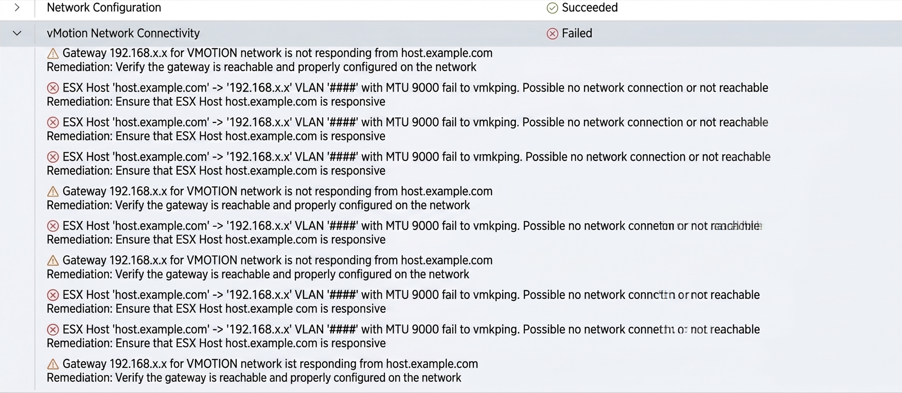

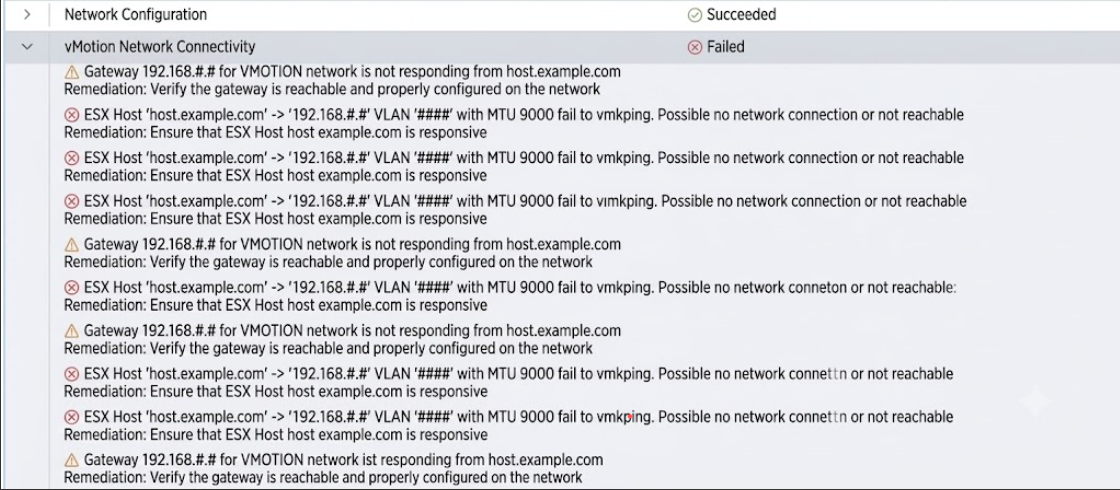

  • During VMware Cloud Foundation (VCF) 9.1 deployment using the VCF Installer, pre-deployment validation checks fails with below error:
  • The gateway (192.168.#.#) for the vMotion network is unreachable from host <host.example.com>.
  • vmkping failed from ESXi host host.example.com to target IP 192.168.#.# on VLAN #### using an MTU size of 9000.
  • /var/log/vmware/vcf/domainmanager/domainmanager.log gives below error:
     DEBUG [vcf_dm,0000000000000000,0000] [c.v.e.s.c.v.util.ResponseUtil,dm-exec-680]  Build validation response: {"errorCode":"NOT_RESPONDING_GATEWAY_FROM.warning","arguments":["192.168.#.#","VMOTION","host.example"],"context":{"severity":"WARNING","bundleName":"com.vmware.evo.sddc.common.validation.er
    rors.messages"},"message":"Gateway 192.168.#.# for VMOTION network is not responding from host.example","remediationMessage":"Verify the gateway is reachable and properly configured on the network"}
    DEBUG [vcf_dm,69d3f3fe3afbbc14de93c54de91dbb6b,49a8] [c.v.e.s.c.v.util.ResponseUtil,dm-exec-679]  Build validation response: {"errorCode":"SINGLE_PORTGROUP_VALIDATIONS.error","arguments":["VMOTION"],"context":{"severity":"ERROR","bundleName":"com.vmware.evo.sddc.common.validation.errors.messages","validation.taskId"
    :"0###3fd-9##e-1##5-8##d-63#######188"},"message":"Failed to validate connectivity of VMOTION network","remediationMessage":"Check input parameters for VMOTION network andverify hosts have connectivity on this network"}
