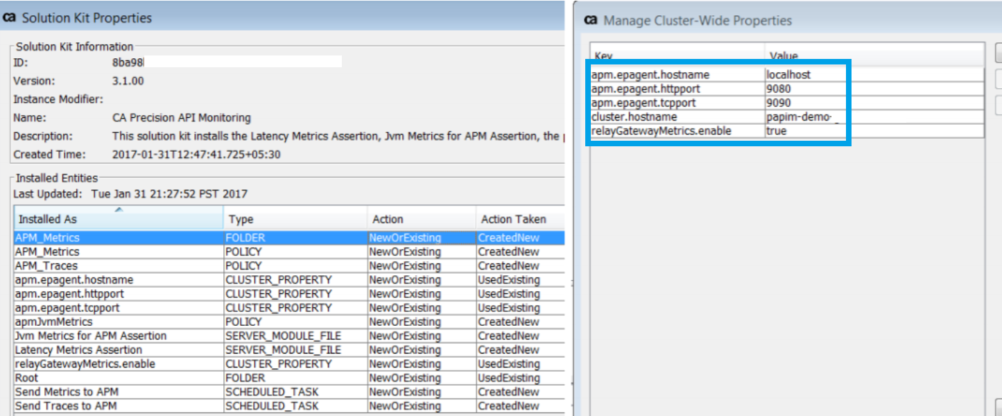

b) In Gateway side
Here is an example, refer to the official PAPIM documentation.
