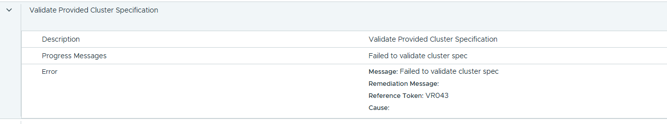

A similar error is observed in the SDDC Manager UI.
