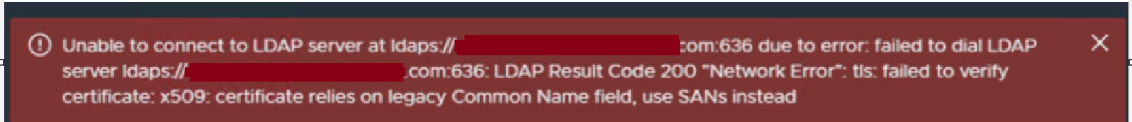

Getting an error with LDAP certificate while doing the LDAP integration.
Unable to connect to LDAP server at ldaps://xxx.yy.com:636 due to error: failed to dial LDAP server ldaps://xxx.yy.com:636: LDAP Result Code 200 "Network Error": tls: failed to verify certificate: x509: certificate relies on legacy Common Name field, use SANs instead.
Fresh install of SSP 5.1.0, SSP 5.1.1
SSP 5.0.0 is deployed and then an LDAP configured using certificate with only Subject Common Name. Now the SSP is upgraded to 5.1.0/5.1.1
The platform connects Active Directory with LDAPS (ldaps://…) and verifies the TLS certificate using the CA bundle supplied. The certificate the LDAP server presents is trusted (chains to CA), but it does not include a Subject Alternative Name (SAN) that matches the hostname used in the LDAP URL.
The client runtime (Go’s TLS library) no longer treats the legacy Subject Common Name (CN) alone as sufficient for hostname verification, so the handshake fails with: certificate relies on legacy common name field, use SANs instead.
