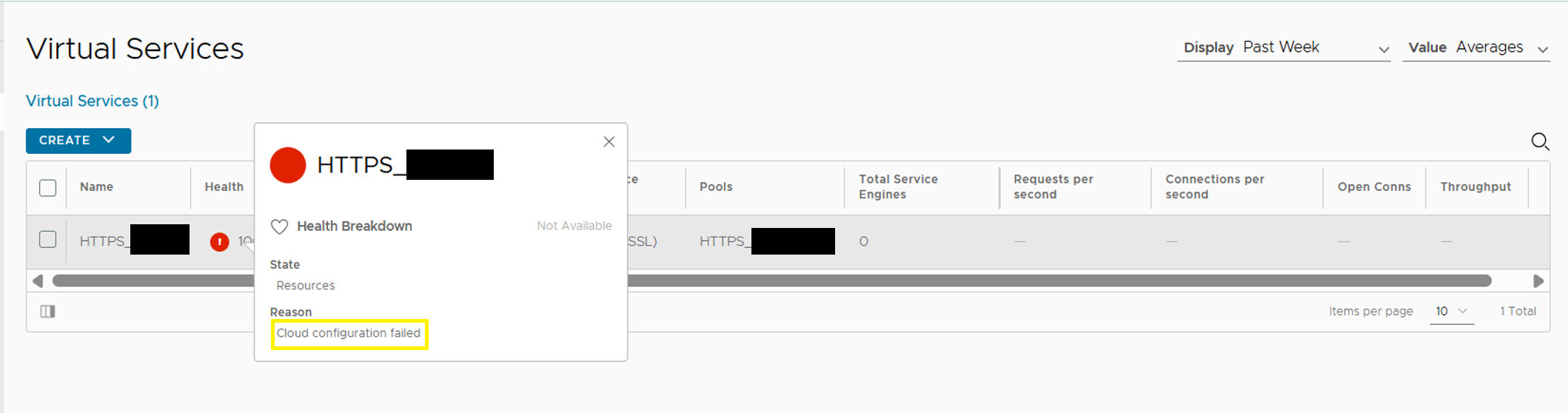

When you deploy a new virtual service, the virtual service fails to deploy with the following error message: 'Cloud configuration failed'
The error message can be seen as follows:

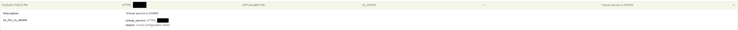

You will see the following event in the Virtual Service Events tab:

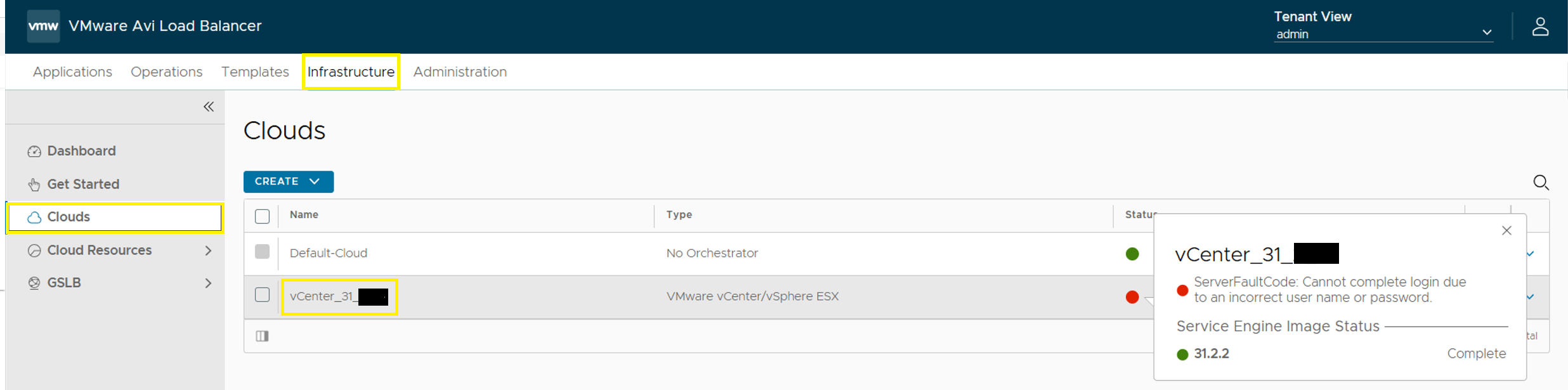

> On the controller UI under Infrastructure>Clouds, you will see the following error:
> On the controller bash, you will see the following logs in cloudconnectorgo.INFO under /var/lib/avi/log:
2026-05-xxT11:xx:xx.134Z ERROR vcenter/vcenter_agent.go:99  ServerFaultCode: Cannot complete login due to an incorrect user name or password.
This error is caused due to incorrect username or password configured for the vCenter cloud under Infrastructure>Clouds.
