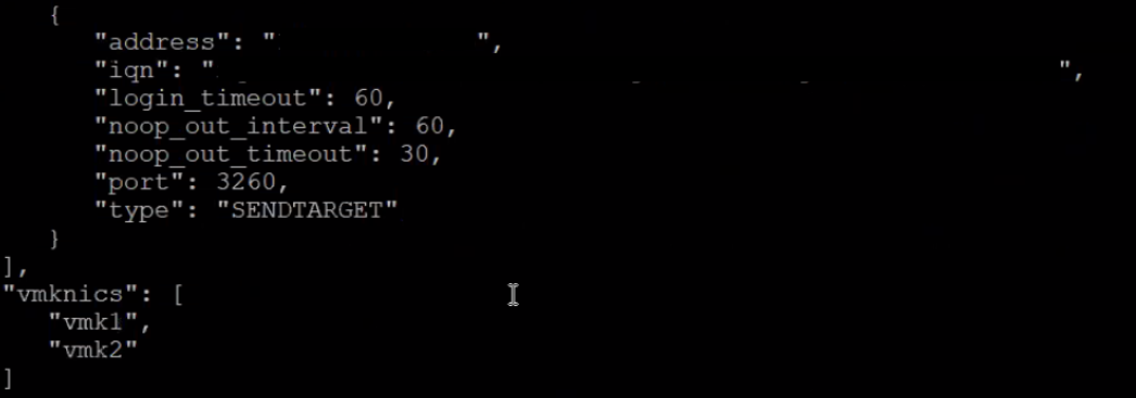

    ++ Under the ISCSIConfig.json file , remove the entry of vmk1 and vmk2 at the end of the file.
    ==> To edit the IscsiConfig. json
  • Press Shift + G key
  • Press "i" to insert the key.
  • Now remove the vmk1 and vmk2 entry as shown in the below screenshot.
  • press ESC key
  • type " :wq" to save the file.
