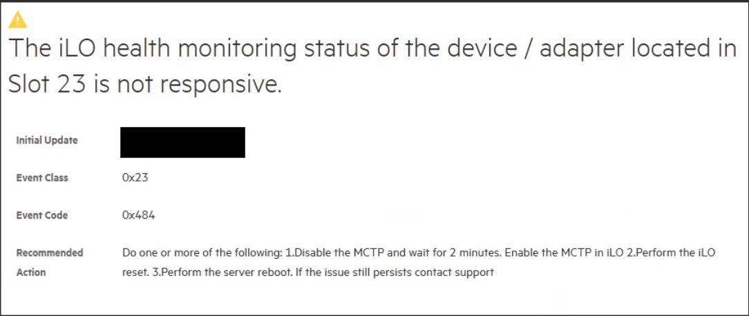

  • IPMI logs on the iLO may report: The iLO health monitoring status of the device/adapter located in Slot ## is not responsive.
  • The device in Slot ## is identified as the NVMe boot device.
