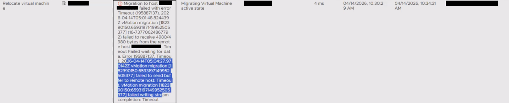

  • Cross vCenter vMotion migrations fail during the memory transfer phase.
  • The migration progress reaches a certain percentage and then stalls, eventually failing with a timeout error.
  • Error Message in vCenter UI: Migration to host <Destination_IP> failed with error Timeout (195887137).
  • Error Message in the source ESXi host logs (/var/run/log/vmkernel.log): "Migration to host <Destination-host_vMotion_vmkernel_IP_address> failed with error Timeout (195887137). <Timestamp> vMotion migration [182390150:6593197149952505377] (16-73770624867792) failed to receive 4980/4980 bytes from the remote host <Source-host_vMotion_vmkernel_IP_address>: Timeout Failed waiting for data. Error 195887137. Timeout. <Timestamp> vMotion migration [182390150:6593197149952505377] failed to send buffer to remote host: Timeout. vMotion migration [182390150:6593197149952505377] failed writing stream completion: Timeout".
