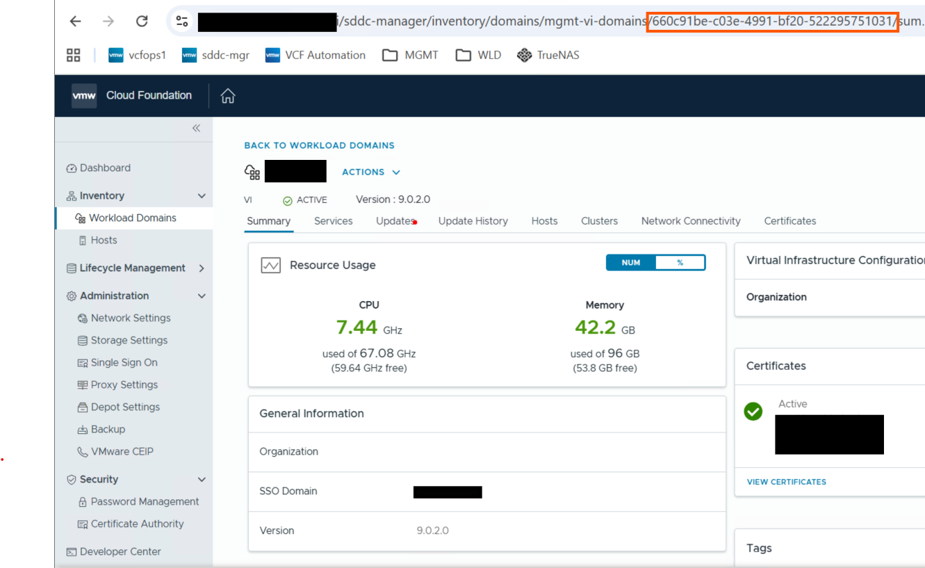

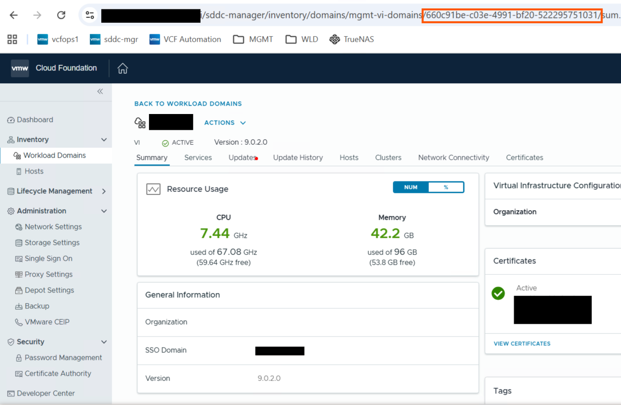

1. Gather the Domain UUID from SDDC Manager
  1. Open the SDDC Manager UI.
  2. Navigate to Inventory > Workload Domains and select the domain that needs to be removed.
  3. Note the Domain ID from the browser URL.

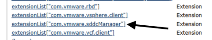

  2. Click Content > ExtensionManager.
  3. Under the Properties section, verify that extensionList ["com.vmware.sddcManager"] is present in the VALUE column.

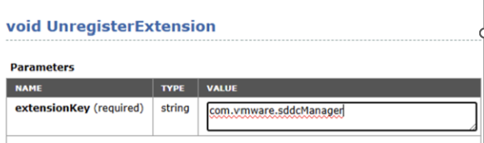

  4. Scroll to the Methods section and click UnregisterExtension.
  5. Enter com.vmware.sddcManager in the parameters value box.
  6. Click Invoke Method in the bottom right corner. Close the pop-up and refresh the ExtensionManager page to ensure it is removed.
