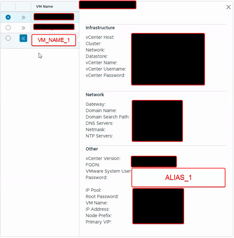

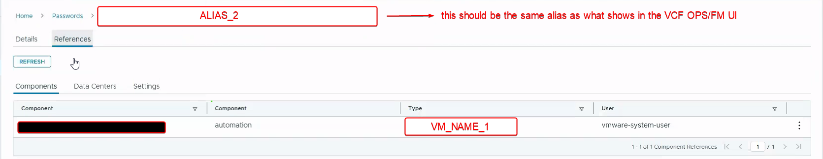

    • In VCF Operations > Fleet Management > Lifecycle > VCF Management > Manage VCF Automation, the VCF Automation component details; vmware-system-user password alias differs from the alias marked as "in use" in the Locker.
    • Triggering an Inventory Sync for VCF Automation does not resolve the alias mismatch.

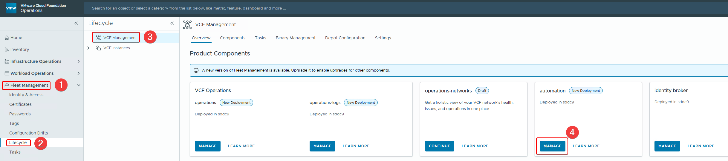

    1. Log in as admin to VCF Operations UI ( https://<VCF_OPS_FQDN_IP)/ui )

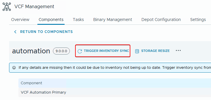

    2. Expand the Left Panel, Navigate to Fleet Management > Lifecycle > VCF Management > Manage VCF Automation
    3. Trigger an Inventory Sync for the VCF Automation environment.
    4. Verify that the Automation component vmware-system-user password alias now matches the "in use" reference in the Locker.

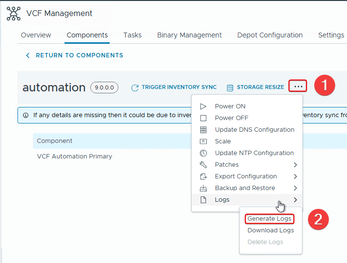

    5. Initiate a new log bundle generation.

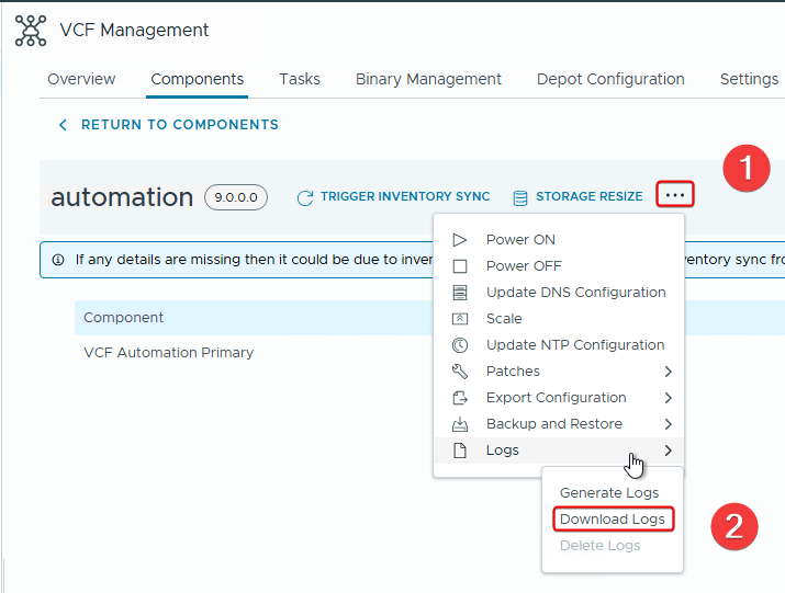

    7. Once the task finishes, download the log bundle from the Fleet Management UI. It should now download the full, populated .tar.gz archive.
