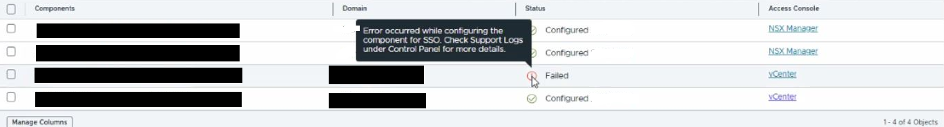

  • Attempting to configure VCF Single Sign-On (SSO) for a workload domain vCenter, the configuration may fail with "Error occurred while configuring the component for SSO. Check Support Logs under Control Panel for more details."

The issue is caused by a synchronization or connectivity drift between the VCF instance and the workload domain vCenter after the upgrade. The "Object Down" status indicates the VCF Operations appliance cannot establish a valid API session, resulting in a 401 UNAUTHENTICATED error during the SSO component registration
Navigating to Ops Console > Administration > Integration > VCF Instance shows the Workload Domain vCenter with:
State: Collecting
Status: Object Down
Message: Unable to connect to VC
Proceed to update the credential for workload vCenter Instance
  1. Log in to the VCF Operations (Operations Console) UI
  2. Navigate to Administration -> Integration -> Accounts -> VMware Cloud Foundation -> VCF Instance
  3. Identify the workload domain vCenter reporting the Object Down status
  4. Perform a manual Reconfigure for that specific vCenter instance
    1. Click on the vertical ellipsis (⋮) next to the affected workload vCenter Instance and click edit
    2. Update the Credential section with the updated password of the configured user
Note: If the registration is using System Managed Credential, this manual step is not required
  1. Verify the status returns to healthy/connected
  2. Return to Fleet Management > Identity & Access > VCF Instances and retry the SSO Configure Component
