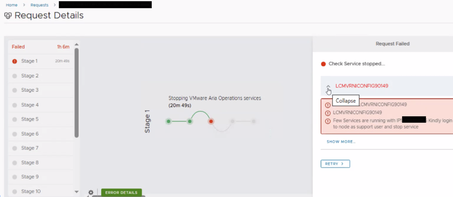

  • Upgrade from VMware VCF Operations for Networks (formerly vRealize Network Insight) version 6.14 (6.14.0.17256887) to 6.14.2 fails with the following error:
com.vmware.vrealize.lcm.plugin.core.vrni.common.exception.CheckServiceStatusTaskException: Few Services are running with IP<REDACTED_IPS> Kindly login to node as support user and stop service
  • Verification via ./run_all.sh sudo /home/ubuntu/check-service-health.sh -p -d confirms all services are up, with the exception of the JournalNode service, which reports a status of "running but not healthy" on one of the Platform Nodes.
  • Upgrade initiated from LCM(Lifecycle Manager) fails with following error:
