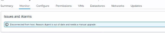

Disconnected from host: Reason: Agent is out of date and needs a manual upgrade"Processing data from vCenter agent on host_name/var/log/vmware/vpxd/vpxd-profiler.log on vCenter shows multiple threads stuck in WAITING_MOLOCK state for the affected Host_ID.ThreadState/ThreadId/####/State/Task::task-####::host-ID::vim.HostSystem.reconnect::#########/State/Vdb/State/Vdb--> ThreadState/ThreadId/####/State/Task::lro-####::::VpxdInvtHostSyncHostLRO.Synchronize::--> ThreadState/ThreadId/####/State/Task::lro-####::::VpxdInvtHostSyncHostLRO.Synchronize::--> ThreadState/ThreadId/####/State/Task::lro-####::::VpxdInvtHostSyncHostLRO.Synchronize::--> ThreadState/ThreadId/####/State/Task::lro-####::::VpxdInvtHostSyncHostLRO.Synchronize::--> ThreadState/ThreadId/####/State/Task::lro-####::ResourceModel::vim.dp.ResourceModel.queryBatch::########/State/WAITING_MOLOCK -- host-ID::vim.HostSystem--> ThreadState/ThreadId/####/State/Task::lro-####::::VpxdInvtHostSyncHostLRO.Synchronize::#########/State/WAITING_MOLOCK -- host-ID::vim.HostSystem--> ThreadState/ThreadId/####/State/Task::lro-####::::VpxdInvtHostSyncHostLRO.Synchronize::################/State/WAITING_MOLOCK -- host-ID::vim.HostSystemVMware vSphere ESXi 8.x
