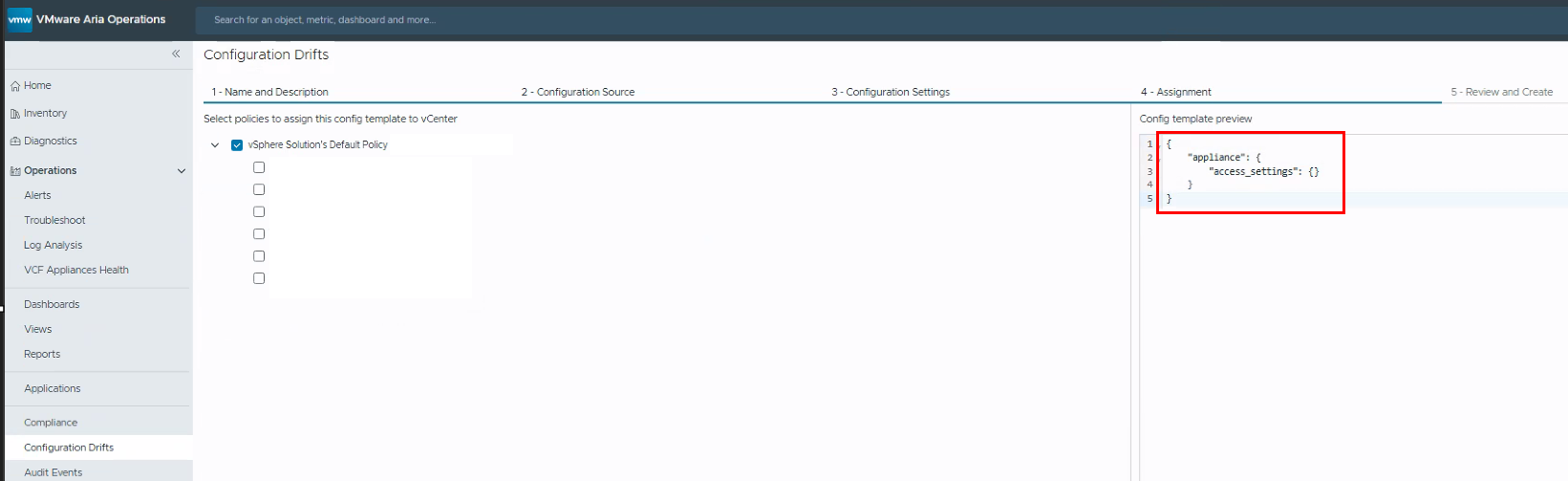

When creating a Config Template in Aria Operations > Operations > Configurations Drifts, the access_settings section under the appliance configuration (in Stage 3 - Configuration Settings > Expand appliance > Select access_settings > Next) appears blank or fails to return data.
Symptoms include:
  • Stage 3 of the Template Creation wizard shows no data for access_settings. (As shown in the screenshot below)
  • vCenter is incorrectly reported as "Compliant" despite having drift.
  • No errors are seen during the "Test Connection" of the vCenter integration.
