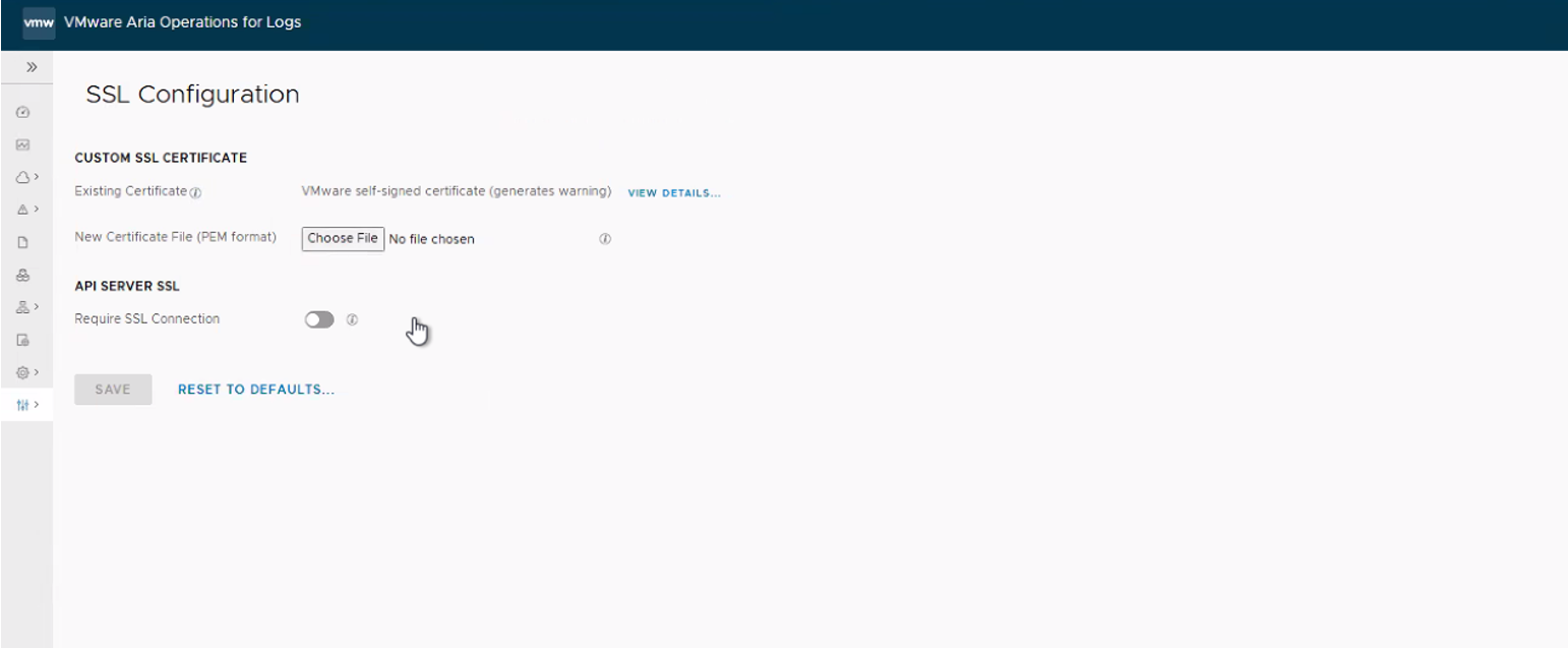

An attempt  to replace Custom certificates via vRLI → SSL Configuration → Choose File, fails with below error
Upload fails with error: “Failed to upload Certificate ['a']”
