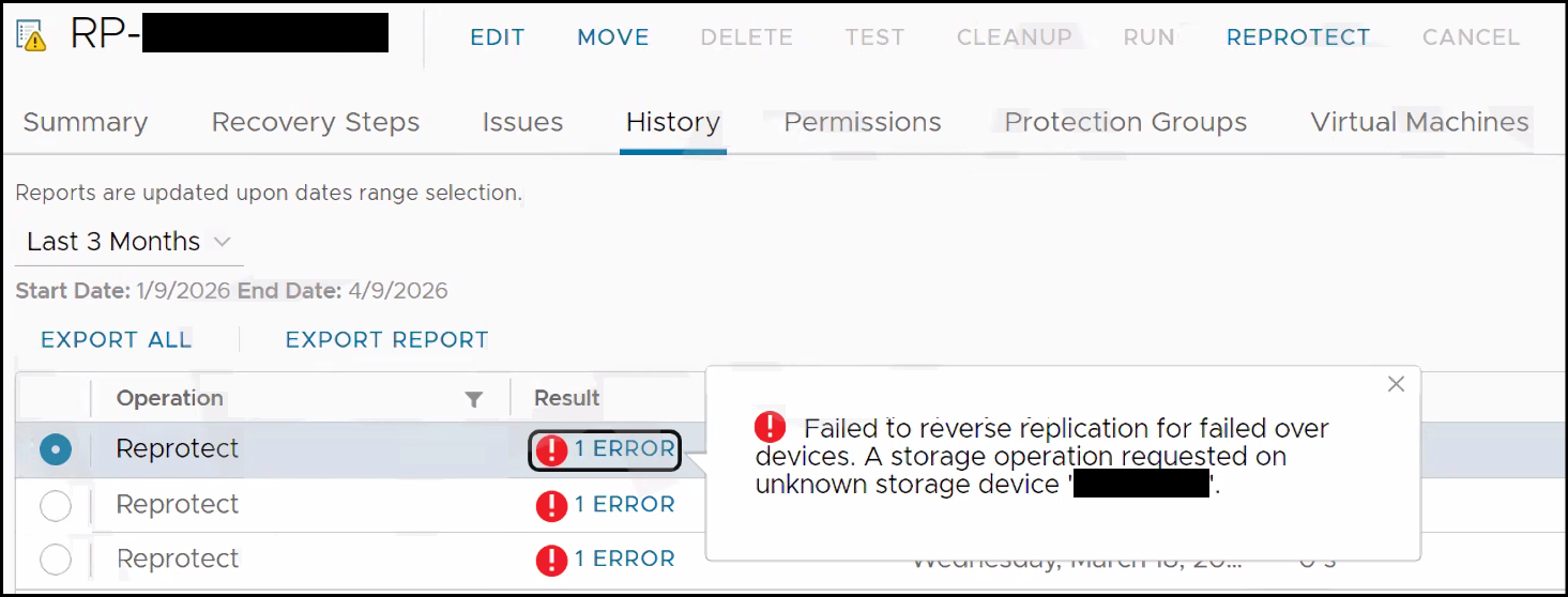

  • Reprotect task from may fail with below error when using Dell Compellent for Replication:
    Failed to reverse replication for failed over devices. A storage operation requested on unknown storage device '#####.###'.
