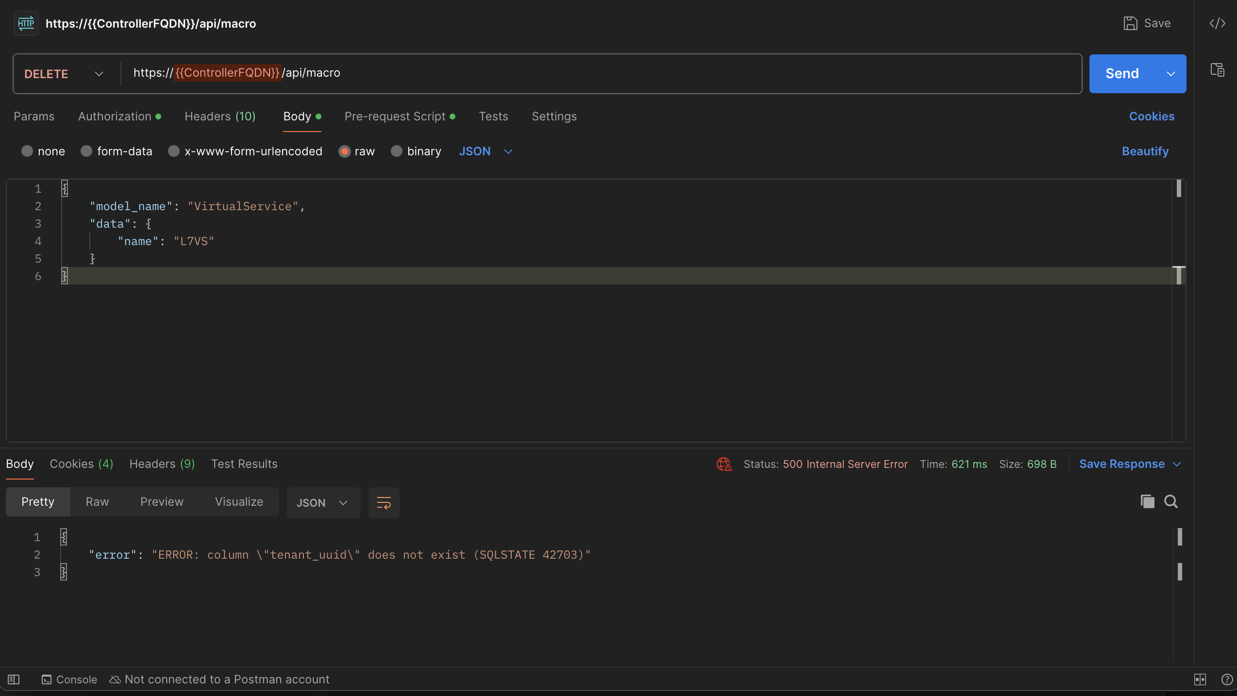

  • with the name of the Virtual Service, resulting in the error "ERROR: column "tenant_uuid" does not exist (SQLSTATE 42703)".

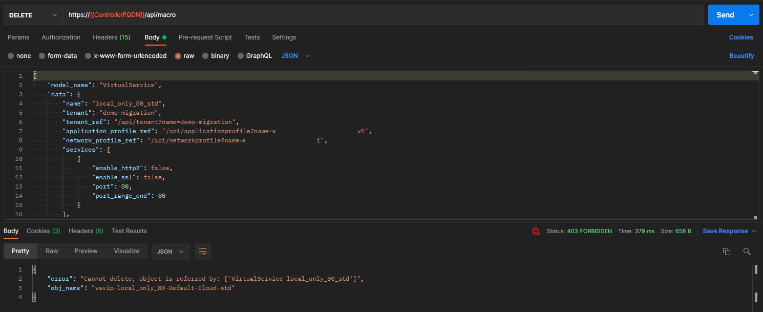

  • with other referenced object fields in the API body, such as vsvip_ref_data 403, resulting in the error "Cannot delete, object is referred by: ['VirtualService xxxx']"
