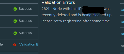

When attempting to prepare or configure VMware NSX on a host, the task fails with a validation error. The user interface displays a specific error indicating that a node with the assigned IP address is in a pending cleanup state.

The NSX Manager database contains a stale entry for a previously deleted Transport Node that occupied the same IP address. The management plane's internal index has not completed the cleanup or synchronization, leading to a false positive validation block during the registration of the new node.
