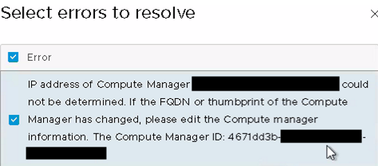

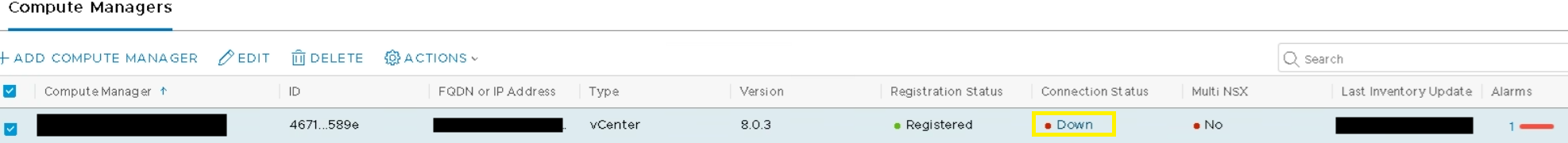

Compute manager registration status is 'Registered' but connection status is 'Down'.
Clicking on the 'Down' button in NSX manager UI shows following error -
NSX manager is unable to ping vCenter using fully qualified domain name (fqdn).
