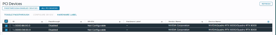

The issue occurs because the physical GPU on the ESXi host is not enabled for passthrough as below
When a host is reinstalled or significantly reconfigured (such as during a "lift and shift") or if the vSS/vDS configuration is reset, the passthrough status of PCI devices may revert to disabled, preventing VMs from accessing the required hardware.

  1. Enable Host Passthrough:
    • Log into vCenter and select the ESXi host.
    • Navigate to the Configure tab.
    • Under Hardware, select PCI Devices.
    • Click Edit and search for your NVIDIA/GPU card.
    • Check the box to enable passthrough and click OK.
