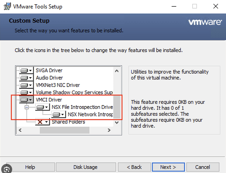

Example of installed drivers

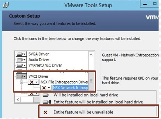

Modify Install > VMCI Driver Section > de-select NSX Network Introspection Driver and NSX File Introspection Driver > Click Finish.
Reboot the VM.
Example of correct removal/uninstall of drivers
