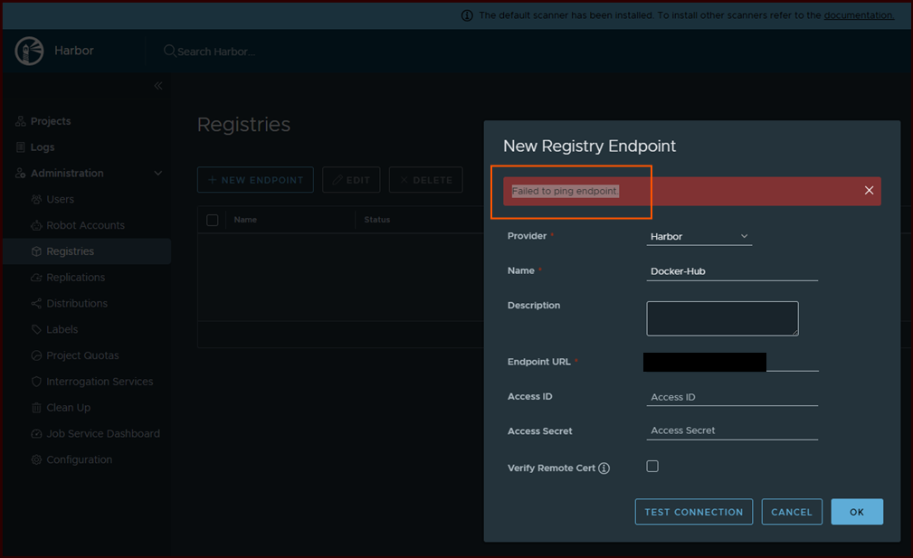

On Harbor UI, it failed with error "Failed to ping endpoint"

  • When configuring a Proxy Cache or Registry Endpoint in the Harbor UI, the operation fails with the error: "Failed to ping endpoint."
